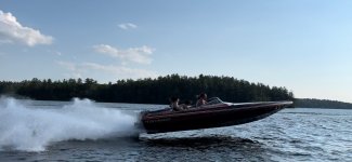

So long story short, I brought home the new ride! I was really surprised at how well the boat came out of the hole (no tabs). it ran great and pulled hard all the way up to 65mph on GPS with half a tank and myself and the previous owner. RPM's seemed a little high at around 4800. Wondering how much better the ride would be with a 24p 4 blade. The 3 blade 23P that is on it is a mirage quicksilver that has seen better days. thoughts?
I am figuring out how to add pictures again, when I do I'll put some up of the new whip. Had a great weekend at Higgins with the family

Still enjoying the Enchanter!
