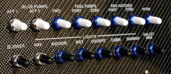

Update:
Corona really put a delay in this project as far as suppliers for parts but things have started rolling in again.
1. Pistons finally came from being coated by Diamond and have been given to engine builder. He is hopefully going to have a motor assembled by next week so rigging can really start to take place.
2. New livorsi throttles came in
3. New switch panels have been ordered from Livorsi. Carbon fiber with different toggles and buttons.
4. I got a wireless/bluetooth/rfid style kill switch from Fell Marine (MOB+). It will be interesting to see how hard it is to install. Its going to need a relay in order to work for both engines. Got two modules that attach to life jacket as well as two wrist bands.
5. Ordered a set of hydraulic hinges from Dana Marine. Going to have to get fiberglass guy to close up holes from the old hinges and I will need to make some sort of backing plate. Went with the stainless braided hoses and will turn the pressure up depending on how well they lift the ZT hatch (500lb cap)
6. Windshield is complete from ocean dynamics and shipped today
7. Headers have finished at heat treat and are going to polisher as of yesterday.
Switch panel picture is just an example, havent gotten them in yet.
