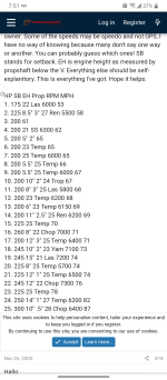

Thank you so much thats a welth of knowledge that I did not know, Im sure next year I will find a 225 or 250 glad you said something because the list I had I was convinced a 200hp would get me where i wanted to be this is the list and it is on this forum.
