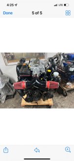

New motor coming for the Cobalt. I’m replacing the 2002 Volvo Penta 8.1L 496 (375 hp) with a 2012 MerCruiser 8.2L 502 (380 hp). It’s going to be interesting to see the hoops I’m going to have to jump through on this mod!

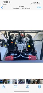

Here's a photo of my freshly rebuilt Volvo Penta 496 (8.1L Gi). Standard horsepower is 375hp. With the GLM exhaust manifolds I used, I'm probably 380-385 hp.
