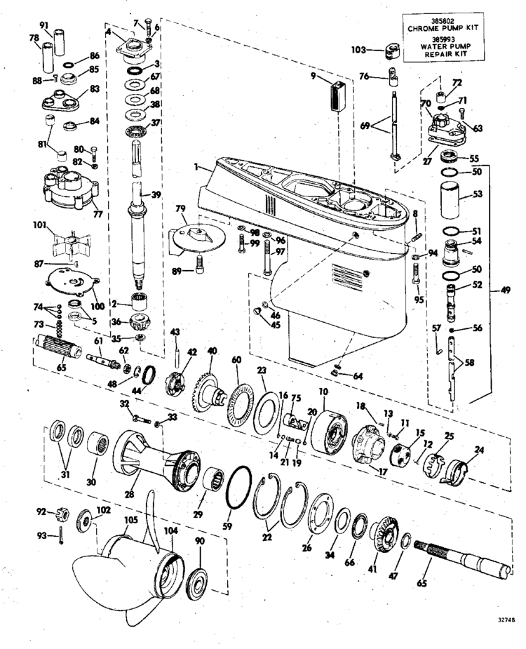

I can't find the alleged connection,under the lower carb that connects the shift lever to the lower unit. This is 1973 evinrude 115hp outboard engine.
I really want to remove the lower unit. What does this connection look like and where is it???

Clarence, take a look at the diagram from Marine Engine.com. Center of the motor bellow the carbs. On the bottom right side of the diagram find the bellcrank and shoulder pin assembly #13. Remove the hex bolt in the middle #12. The front half of #13 should separate and come off enabling you to slide the shift rod connector off of the end pin. The end pins are "captive" so you don't have to worry about them falling off. Hope this helps.:thumb: Jim
