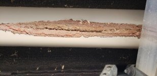

I have a few spots like this in various areas. Anyone had this happen with their Checkmate? The vertical gap where the overlap from the bulkhead has pulled away from the stringer.
Is this a red herring for the worst possible scenario?
The waterlines are concerning to say the least as well as there is about 3" of water in this pocket. There is no way for this water to drain out..

If it’s “cracked” like that there is water intrusion and most likely rot. I would assume the worse and start investigating further. My 2000 Persuader had a separation similar to that and you could insert a screwdriver and probe all the wet/ rotted wood.
I am currently getting a gouge in hull fixed. Once I get the boat back I am going to really clean everything up and start investigating. I see seepage so there is definitely rot in that bulk head. I dont see any way to even access that portion of the boat. Assuming the others are in the same condition.
If thats the case, I am going to find someone who can just crack this thing in half and fix everything structurally before I go any further. I know Checkmate does OEM restoration but not sure how busy they are.
I have never done fiberglass work, but I do have the capabilities just not the time. The time value of money for me would be greater just paying someone else to fix this correctly. The focus though will be someone doing it 100% right the first time because paying to have it done right the second time is the worst.
Should have boat back from fiberglass guy this week fixing the gouge in the hull. Then I am going to pull motors and drives. Thoroughly clean the bilge etc... He had to cut a hole in the floor when you step into the cuddy cabin to patch the damage to the keel from the inside also. I told him not to glass that back in until I figure out why the tabbing on the bulkheads has seperated from the stringer. I can only assume its like this in more places.
I didnt have the boat but 3 days before I got it to a glass guy to fix the bottom so I havent had a chance get a thorough inspection of the nooks and cranny's.
Fingers are crossed that I somehow dont have rotted stringers and transom. Maybe I will get lucky, but this would be the first time.
Depending on how they tie that bulkhead into the stringer I may be ok. Hopefully they glass the stringer in and then the bulkheads so that if that ever seperated then water couldnt get into both the stringer and the bulk head.

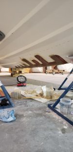

I realized I had never put any pictures of the keel damage. Previous owner damaged the boat on the trailer. Didnt back it in far enough, bunks are too low. I am raising the bunks. Here are some pics from before and as they are in the process of fixing it.

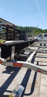

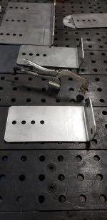

Guy is still working on the keel. I went ahead and made some new brackets for raising the bunks on the trailer. I saw a guy on here with a factory trailer for a zt330. It had bunks on basically every chine. I will add more flat bunks once the boat is back on it.

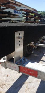

I will end up putting two bolts per bracket, just wanna make sure height is good before I go drilling extra holes.

Kind of felt a little ill looking at the damage. That wasn't going to buff out. Apparently the previous owner power loaded at 15 knots or so? What about brackets to turn 2x4 bunk sideways so that the wide aspect of the bunk is against the sacred Checkmate fiberglass. No keel protection or roller present on trailer? Also, what is weight of ZT 330.
I couldnt agree more. I found pics of an oem checkmate trailer for zt330 from a guy on the forum MindBLOWN. He has a very nice 330. It has bunks all over the place. Once I get the boat back from fiberglass, motors pulled, drives pulled etc..inspect stringers...then I'm gonna basically make all new bunks like you are describing.
It's been 19 years since we had a checkmate. I forgot how nice the factory trailer was when it said "ZT260" at the bow.
This boat came with a real nice aluminum. Just doesnt have correct bunks.
