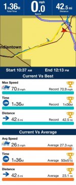

Did a turkey day morning run and recorded my highest top end speed in my Pulsare 2400 Bowrider/Verado 300 Pro! 70.9mph!! Not too shabby for a family sled!! It was 82 degrees and flat water!!
