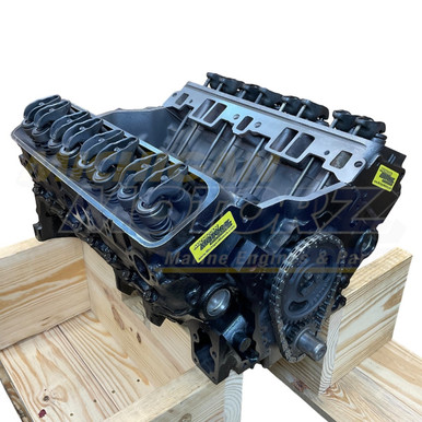

Sounds like the winter storm in Texas wiped out a lot of inventory this year caused shortages. As others have said figure out the exact problems with yours first. Should be a fairly easy swap for a long block worst case. A 350 really should not cost that much. For example-
Good luck.
Good luck.
Thanks for the lead! I'm gonna follow up with my mechanic and see what he says...
