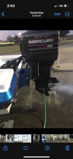

I'm just beginning to dial in my Starflite but so far 78mph with a Mercury Pro XB250 at 11.5" of setback, propshaft dead even with the bottom, Trophy Plus 27 @ 5700-5800 rpm...

He quoted 82mph but it had to be a handful to drive. The bypass valve on the SeaStar 1.7 helm allows the fluid to pass at speeds approaching 75mph which makes it near impossible to balance the boat on the V pad bottom. I'm constantly steering to the right trying to keep the boat running straight instead of focusing on balancing the boat on the pad. The motor is also deep and needs to be raised to the next set of holes on the clamp. My propshaft is dead even with the bottom of the boat and I have 25lb of water pressure. It's dial in time and seat time now. I expect mid 80's when all is done...

Haha... I am probably not the guy to ask about Merc lowers. Maybe a Merc guy will chime in. I can tell you that the Starflite likes a 250. Without the pad of the Pulsare they need that extra kick to get them out of the water and pull decent numbers. 26" of setback? Seriously? Show us a pic!
Setback is calculated from the drain plug, end V hull or pad. the starflite has a 6” recess setback from the transom. I only have a 10” “jackplate” setback.
Check out the post on BBC forum
Well the 250 vs 225 same motor, weight etc. 225 is just tuned down for regulations. Hemce the introduction of the Gen2 lower unit with the “wings”
