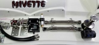

Cannot wait to drive her with the new dual ram hydraulic steering. The headers look awesome and I was told she sounds like a beast, can't wait.
