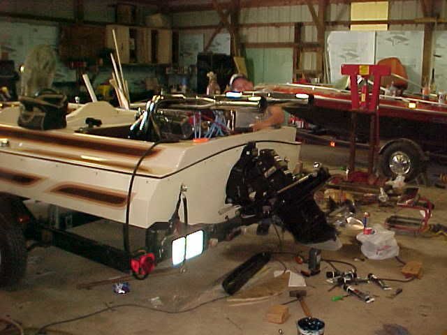

http://i279.photobucket.com/albums/kk129/Reed65/jeromyworkinonhisCenturion.jpg?t=1212553090
This is my competition , my buddy Jeremy workin on his boat ( yes the jet drive was replaced and outdrive added ( 450hp 355, with a 26 pitch 5-blade stainless prop ) ( he's building a 800 hp blower motor for this boat ~sheeze and they say I'm Nutz~
